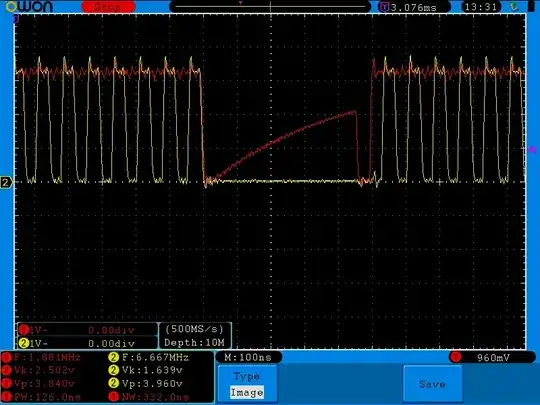

While I was probing the communication between the microcontroller and the SD card, I noticed that on the MOSI pin, there's a waveform that reminds me of a capacitor charging.
MOSI line getting charged, MISO line high
Red channel is MOSI and yellow channel is MISO.
At first, I thought that it could be the MISO line charging the parasitic capacitance between the MISO and MOSI pins on the development board, since those two pins are next to each-other. After probing some more, I came to the conclusion that this is not the main cause of the phenomenon.
MOSI line getting charged, MISO line low
Here we can see that there is still some charging action on the MOSI line, even thought the MISO line is low at the moment.
On the SD card adapter itself the clocl line is in between the MOSI and MISO lines, so I thought that it could be causing the issue, but while the MOSI is getting charged, the clock line is low as well.
[MOSI line getting charged, clock in yellow, 1
Red is the MOSI line, yellow is the clock.
Here's a shot of the smaller "triangle" and the clock line:
MOSI line getting charged, clock in yellow, 2
During all this, the Chip Select line is held low, so it could not be charging the master out pin.
So any ideas what could be causing this type of behavior?

    Is it possible that you are accidentally changing the MOSI line to an open-collector output, or to an input with a weak pullup? – Joe Hass Dec 19 '13 at 13:19
  • @Joe Hass I'm not sure, this is my first "real" project with this micro and I still haven't digested the libraries used here. On the surface, it doesn't look like that is happening, but until I dig through the source code, I can't say for sure. The micro does have option to set outputs to open collector. – AndrejaKo Dec 19 '13 at 13:23
  • Are you showing all your code stuff because you think it may relate to your code? – Andy aka Dec 21 '13 at 23:20
  • @Andy aka Well yes. Maybe it would be a bit more accurate to say that I can't say that the piece of code I'm using is not related to this. At the moment, I don't see how the code I posted could produce the shown effect, but I'm not yet comfortable enough with the toolchain to say that the error isn't in the code. Actually, I suspect that is probably is somewhere in one of the called functions, since the microcontroller does have weak pull-up resistors as a feature, but they should be disabled during the whole procedure, as far as I understand how things work. – AndrejaKo Dec 22 '13 at 00:07
  • maybe if it's possible program the pull ups to be more regular values like 10k or just put a 10k resistor external. It looks like cap charging and with a known lowish value resistor, the charge curve would tell you the line capacitance and yield a better explanation. – Andy aka Dec 22 '13 at 00:15
  • @Andy aka Yeah, it would be useful to get a rough value of the capacitance and then try to compare that with values of the pull-up resistors. This would allow me to determine if they are the cause. I'll add that to the list of things to try. – AndrejaKo Dec 22 '13 at 00:19
Looks like your MOSI line is being Z-stated sometimes and weak pull-up on this line is charging it up. This is not cross line interference.
