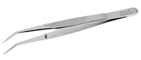

I use a set of tweezers as part of my toolkit, and they have a hole in one arm and a corresponding spike in the other. Why?
Tweezer Example

The spike is called an "alignment pin" and is useful for very fine tweezers that might twist or bend slightly, causing the tips to misalign.
Here's an example at Aventools:
Tweezers with alignment pin

I have never hear a good explanation, but this is my personal thought:
If the tweezers have sharp ends (like the ones in the figure) they can mechanically twist slightly so that the ends of the arms do not meet perfectly. This in turn makes it difficult to hold the smallest SMD components. The spike and the hole force the ends of the arms to be aligned.

It is an alignment pin. It is used to ensure that the ends of the tweezers do not twist while holding small objects. Unfortunately most people don't realize they are there and find out they exist the painful way.
Aside from the alignment purpose, it also allows you feedback. That is to say, it lets you know when the tips have pressed together, and how much.
