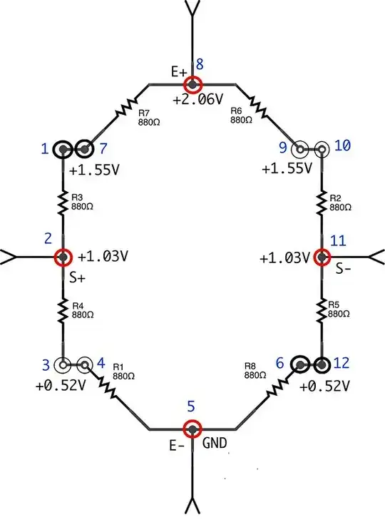

I have a kitchen weight scale containing four half-bridge load cells, each cell associated to one foot of the scale.
I want to hack it to use it as a pressure sensor and link it to an Arduino microcontroller.
With resistance measurement, I have deducted the sensors were linked using this configuration:
mia scale load cell circuit_schéma
I have removed the original PCB and connected the sensors together the same way and also to an opamp (INA122) using the E+, E-, S+ and S- connections.
However I do not have consistent values according to the place where the pressure is applied.
I am now thinking about building four parallel bridges, each containing one load cell and three regular resistors. Each bridge would be connected to its own opamp. This would allow to better calibrate the output of each bridge and improve the balance between all of them.
  1. Is it a good way to combine the sensors and get a position-independant measurement ?
  2. Is there a better combination ?
Thank you in advance.

In order for the bridge to produce an output between S- and S+ the bridge must become "unbalanced" when weight is applied. So if all 4 load cells produce equally increasing or decreasing resistances when weight is applied the bridge will remain balanced and the output will not change.
If the load cells are arranged such that the left and right halves of the bridge move in opposite directions, then the difference between S- and S+ will increase when weight is applied.

  • @nesdnuma : No. If you flip the active/passive parts of the cells around properly when you wire them up into the bridge, then when the weights are physically translated into tensions and electrically into increases in resistance, you can make them add constructively and increase the S+/S- voltage imbalance. If you have (for example) R7 & R6 swapped backwards, so that tension/resistance in R7 increases with weight/tension, then it would end up reducing the S+ value. – Dave X Nov 06 '15 at 21:01
  • ... It also depends on the gauge. Rather an one active element and a temperature compensating element, some gauges have two active elements but opposing in sense. Still, nedsnuma needs to set up the polarities so that the E-/S-/E+ voltage divider moves opposite to the E-/S+/E+ voltage divider. See http://electronics.stackexchange.com/a/199470/30711 for – Dave X Nov 09 '15 at 19:10
For maximum sensitivity and linearity, you want to have one Wheatstone bridge with four active elements, and not four separate bridges.
See Kester's AD chapter on bridge circuits for an exhaustive treatment: http://www.analog.com/static/imported-files/seminars_webcasts/49470200sscsect2.PDF

  • The 4 strain gauges are all in tension on the bathroom scale sensors, and should grouped 2 each on opposite diagonals, with their integral temperature-compensating resistors on the other two diagonals. – Dave X Nov 06 '15 at 21:08
  • Oops -- Some load sensors have two strain gauges-one in tension when the other is in tension. You can still build a wheatstone with 8 active elements, if you are careful about the signs. See http://electronics.stackexchange.com/a/199470/30711 – Dave X Nov 09 '15 at 19:04
I think your wiring arrangement is ok. However, I would bet that one of the half bridges is wired backwards.
To determine which one might be wired backwards, I would connect a digital volt meter to the points labelled S+ and S-. I would make a note of the reading with no pressure applied.
I would then apply the same known weight to each corner (half bridge) one at a time.
If I guessed correctly three voltage readings will increase (or decrease) in one direction and the fourth will decrease (or increase). The odd one is wired incorrectly. If two increase and two decrease, I would reverse the wiring on decreasing ones.
Jeff
  • 176
  • I have made that test but whatever the load cell tested the output voltage always increases. – nesdnuma Dec 08 '13 at 04:06
    When you apply the same weight to each load cell the output should change the same amount. Half bridge load cells are more sensitive to off center loading and side pressures. So you need to make sure the four cells have continuous contact on a flat surface. – Jeff Dec 08 '13 at 15:08
  • So how is it possible to have a measurement without being dependant on the position ? – nesdnuma Dec 08 '13 at 19:35
    The outputs from the load cells need to match and all of the mechanical mounting and forces need to match. If the load is applied in the middle between two load cells they each receive half of the load. As the load is shifted towards one load the weight divides 40/60, 25/75, etc. – Jeff Dec 08 '13 at 20:29
