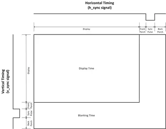

Here is just a nice diagram of timing of hsync and vsync (just a good reference):
VGA Timing

  • It may help to recall that back in the day, video was produced by steering an electron beam. Sync pulses were roughly those intervals in which the beam could be snapped back to the left (HS) or top (VS). The 'porches' are nothing more than some margin to allow the beam to get back into the visible display area. Porch times basically adjust the centering of the image. Get the overall line time right, and you can divvy it up between the porches and the active pixels more or less however you like. – JustJeff Dec 07 '13 at 04:00
  • @JustJeff I knew that a CRT worked with a electron beam and scanning it across the screen but it did not quite click that the signal I am sending to the screen explicitly controls the analog circuitry in the monitor instead of it being interpreted and beamed out (the beam just being the technology running the screen instead of a lcd). When you change the position option on the monitor you essentially modify the `back porch` values and I have added a couple of range inputs so people can align their signal. – MLM Dec 07 '13 at 06:17
  • @JustJeff: Although VGA is usually output using separate wires for the for sync signals, it was hardly uncommon to feed it into monitors that expect sync to be superimposed on the "green" signal. Extracting sync from a composite signal requires that the signal be at a consistent stable voltage before the sync pulse; the front porch ensures that's the case. If VGA did not include a front porch, then VGA-to-3-wire adapters would have had to delay horizontal sync in order to add one. – supercat Dec 07 '13 at 23:24
  • @JustJeff: The "analog" behavior of monitors makes it possible for monitors (especially monochrome ones) to show a variety of resolutions "perfectly", unlike LCD screens which have a particular fixed resolution and have to scale any other resolution up or down. – supercat Dec 07 '13 at 23:30
  • @supercat - just trying to lend some perspective to the situation. Often in electronics we find seemingly strange interfaces that preserve odd bits of OBE technology. Thanks for expanding on this. – JustJeff Dec 08 '13 at 15:33
EDID is used, among other things, to query the monitor for the timings it would like. It isn't used to transmit any video information.
I guess it's been so long that no one remembers, but VGA monitors back in the day had adjustments for the image location on the CRT. You could move it left or right, up or down, or scale it horizontally or vertically. More advanced monitors had additional adjustments. These allow you to compensate for whatever timing was in use, whatever local magnetic field there might be distorting the picture, etc.
Of course, what these adjustments are doing behind the scenes is adjusting the timing parameters. They were necessary because the VGA signal doesn't explicitly say how much blanking time there is. As you've noticed, there are some general conventions, and the monitor can (through EDID) advertise support for particular timings, but there's no requirement that those timings are what will be sent to the monitor.
What you can do, and what LCD monitors that still have VGA interfaces do when you press the "auto adjust" button, is guess at what the blanking time might be simply by looking at the R, G, and B signals. These should be black for the blanking time, and probably they aren't black otherwise. Of course someone could be looking at a black screen, and this approach won't work.
Similarly, I don't think there's anything in the VGA signal that will tell you what the resolution is. You can guess at it by looking for the edges between pixels, and timing them, and this is again what LCD monitors do. But remember, VGA is an analog signal, designed to be displayed on an analog device. It has no concept of "pixels".
