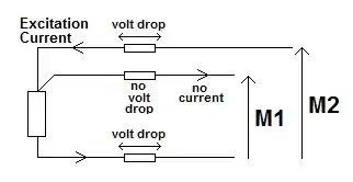

With a 3-wire RTD connection you need to measure two voltages: -
The difference between M1 and M2 is the volt drop down the top feed wire and it can be presumed that the same volt drop is down the ground return wire therefore actual voltage across RTD is M1 - M2. To convert this to temperature you need to know the current down the wire and this can be achieved by using a precision current source (i.e. it has a known value).
If you used a precision resistor from say 5V and you used your ADC to measure its volt drop you then know what current is flowing. You did say you have plenty of ADC inputs!
If your ADC's voltage reference can be tied to the same voltage that feeds the precision resistor, measurement M2 tells you the volt drop across the precision resistor and, if the supply voltage is stable and reasonably precisely known then this tells you what the current is. This now just requires two ADC measurements.
