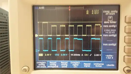

The good news is I can fix this problem by adding a 100nF cap between VCC of my counter and GND. I examined it with an oscilloscope on the picture below. To the left of the middle line, you can see the behavior of the counter without the cap and, to to the right, the 'fixed' counter with a cap between VCC and GND. (Yellow is the input signal, Blue is QA. Please don't mind the input fluctuations as I was powering using my Arduino, the same occurs when I use a steady voltage source.)

    Is that "4.12V" shown on the scope supposed to be a 5V logic signal? Are your supply rails sagging? Can you post a full schematic or at least a couple of clear photos of each side of the PCB? – pjc50 Nov 27 '13 at 09:55
  • So, what do you think is causing that little voltage step-down on QA at the clock rising edge? That doesn't look right. – user28910 Nov 27 '13 at 12:53
  • Showing us a scope photo and then saying that we should disregard the sagging power is confusing and not very helpful. Give us a decent scope photo so we can judge what can be disregarded and what can't. I have a feeling that your 555 is disturbing the power supply. – Joe Hass Nov 27 '13 at 13:17

  • @JoeHass, I will recheck with the scope as soon as I can then, I know it looks like there are many issues with what I currently have and that the power rails are sagging, I judged it okay to post that picture at first because it was the only I had for now and the same behavior appears using a sturdier, regulated source. I believed my problem could maybe be related to some 'common phenomenon' or 'mistake' since I am one of many in my class to which this occurs. Thank you for your time I'll get back as soon as possible. – user33355 Nov 27 '13 at 16:43

At first glance, this appears to be a power problem. It appears that your "5 V" power supply droops to less than 4 V in operation.
Unfortunately, these 3 problems bite extremely often, and cause all kinds of strange and not-quite-working-right behaviors.
