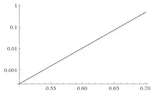

The Ebers-Moll model for the emitter current in a bipolar transistor is:
\$I_e \approx I_{es} e^{\frac{V_{be}}{V_t}}\$
Where \$I_e\$ is the emitter saturation current, \$V_t\ \approx 26mV\$ is the thermal voltage, and \$V_{be}\$ is the base to emitter voltage. For a value of \$I_{es} = 10^{-12}\$ (in the typical range for a small signal silicon device), consider the following Wolfram Alpha plot of the above equation:
Ebers-Moll plot
The Y axis is current and is on a logarithmic scale. You'll notice that for values of \$V_{be}\$ in the range from 0.55 to 0.7 volts, the current through the transistor has an extremely wide range - from microamperes at the low end to an amp at the high end. This is due to the exponential behavior of the governing equation.
For the purpose of analysis, assuming that the \$V_{be}\$ of a small signal silicon transistor for when it is in this range for when in the active region is a reasonable assumption, since if the value of \$V_{be}\$ were significantly smaller only a tiny current would be flowing through the transistor, and if it were much larger, the transistor would have to be passing amperes of current, which is not physically possible for such a device.
Again note that this is only an assumption to facilitate analysis; the \$V_{be}\$ of a specific small signal silicon device in a specific circuit should be in this range if it is in the active region, but the actual value will depend on circuit specifics, device parameters, temperature, and other factors.
