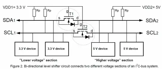

You can do it using exactly two transistors, which is pretty slick.
alt text
This comes straight from a Philips application note.

  • I have one of those at home, just not sure on how to hook it up as I2C has more than one line. and is bi-directional – Ashley Hughes Jan 19 '11 at 00:46
  • According to some of the user comments on that page, the 'TX' lines are supposed to be bi-directional. So I assume you'd connect SDA to TX1 and SCL to TX2, for example. – Craig Jan 19 '11 at 12:01
    If you look at the Data sheet It is almost the same as the Schematic that vicatcu posted in his answer. And as experience goes they are bi-directional. – jsolarski Mar 05 '11 at 23:01
