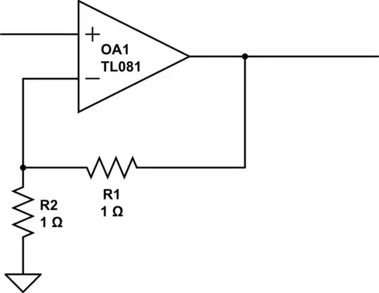

  • Why do you think the opamp will work with resistors that are only 1 ohm when its datasheet shows 2000 ohms minimum?? Even a power amplifier will be overloaded by the 1 ohm resistors. – Audioguru Oct 17 '21 at 16:25

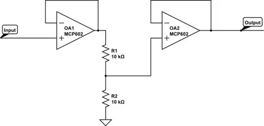

If you want the advantages of the non-inverting amplifier with gain \$\ge\$1 (high input impedance, low output impedance) you can use two op-amps as follows:
Here R1/R2 are a voltage divider that provides that actual gain of 0.5 and OA1 and OA2 are simply voltage followers.
One limitation of this configuration is that the voltage follower OA1 must be able to follow the input over the full range, so if the input approaches the supply rails too closely it may not work accurately.

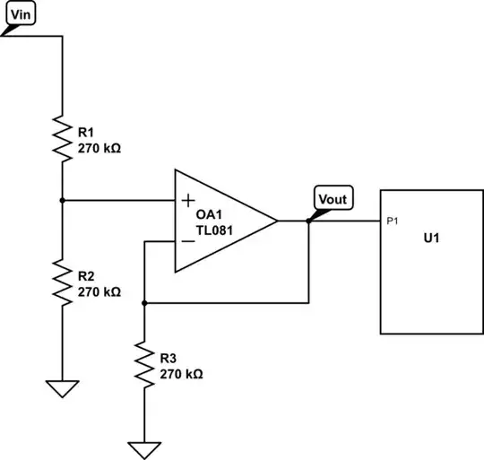

To have a non-inverting operational amplifier configuration with a gain of less than one you can do the following:
  • Place a voltage divider at the input of the non-inverting amplifier. Calculate R1 and R2 to obtain the gain you want. In this example, as the two resistors have the same value, the gain of the voltage divider is 0.5
  • Short the feedback resistor (0Ω). You want the amplifier to have a gain of 1, so the overall gain is the same as the voltage divider alone.
  • The R3 can be any reasonable value, I've just used 270kΩ so it's the same as the others.
The advantage of this set up over a simple voltage divider is that the amplifier provides enough current to feed the next step (represented by the U1 module, which can be whatever device). Therefore you can use much higher resistors R1 and R2, so there is very little current drained from the source.
