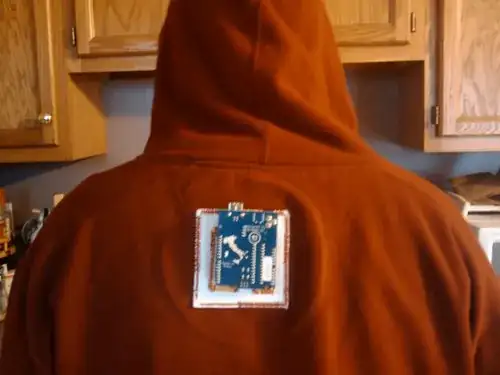

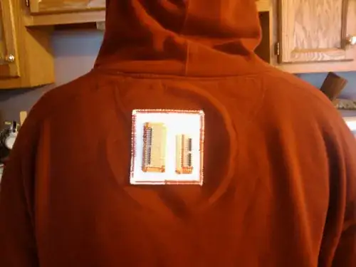

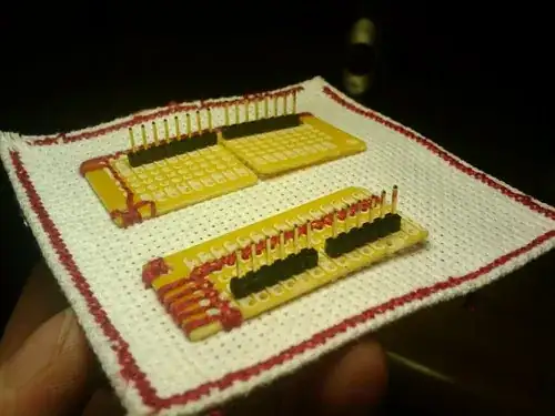

I have a Lilly Pad, along with several Arduino boards. I've been wanting to do some sewable/wearable projects but just didn't want to ruin the Lilly Pad on a mistake. So after reading Pulsea's instructable: http://www.instructables.com/id/Sewable_Arduino_Interface/ I decided to make a "fabric shield" for a regular Arduino. It's currently a work in progress, but here are some pics:
http://www.flickr.com/photos/morgellon/4182789768 http://www.flickr.com/photos/morgellon/4182769288 http://www.flickr.com/photos/morgellon/4169401395
