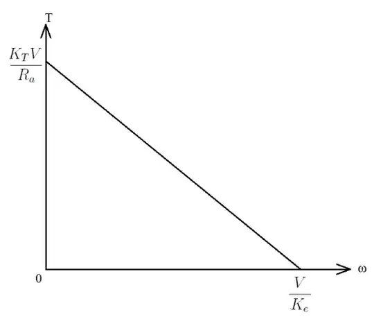

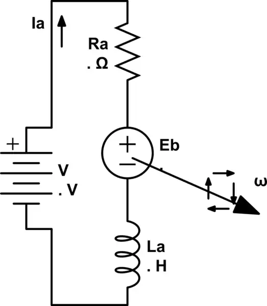

This is a steady-state approximation of a dc motor that works fairly well with some types of dc motors(see comment by supercat). Since steady-state, the armature inductance \$L_a\$ is neglected. We have the following: \$\$\begin{align} V &= \text{input dc voltage}\\ R_a &= \text{armature resistance}\\ E_b &=\text{back-e.m.f}\\ \omega &= \text{angular rotational frequency of shaft} \ =\frac{2\pi \cdot \text{speed}}{60}\\ I_a &= \text{armature current}\\ K_e &= \text{back-e.m.f constant}\\ K_T &= \text{torque constant}\\ T &= \text{shaft torque} \end{align} \$\$ and the following equations apply: \$\$\begin{align} E_b &=K_e \cdot \omega ...(1) \\ T &= K_T\cdot I_a ...(2) \\ E_b &= V-I_a R_a ...(3) (\text{obtained from equivalent circuit shown})\\ \text{from the above 3 equations,} \\ T&=\frac{K_T V}{R_a}-\frac{K_e K_T \ \omega}{R_a} \end{align} \$\$ The equation relating torque and speed(or frequency) is graphed below , clearly showing torque is inversely proportional to speed: enter image description here

  • The other answers amply cater for your conceptual doubt. My answer focuses only on the torque-speed relation. – K. Rmth Nov 19 '13 at 21:45
  • I don't think it's a good approximation for series-wound motors only if current is fixed, or for shunt-wound motors only if the voltage is fixed. Otherwise the torque "constant" of the motor will depend upon the armature current, which will in turn depend upon the voltage drop of the rotor, which will in turn depend upon the torque [non]constant. Note that a series-wound motor driven with a constant voltage would run infinitely fast in the absence of *mechanical* friction or loading (despite the presence of electrical resistance!) – supercat Nov 19 '13 at 21:51
  • @supercat yes,my bad since i had the habit of working with this type of equivalent circuit and for the motors you mentioned,assuming the motor is operating in a range where the variations are negligible. I edited my answer following your comment. – K. Rmth Nov 19 '13 at 22:07
