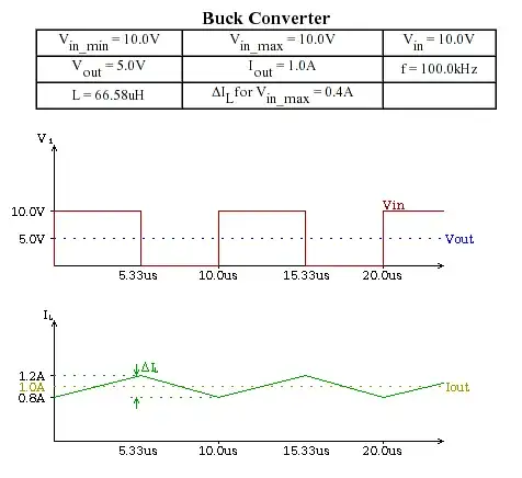

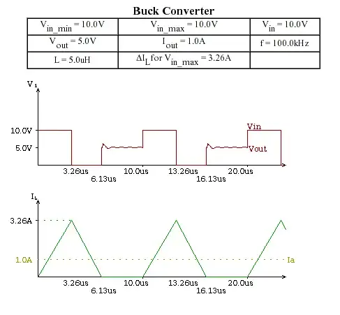

Increasing the value of the inductor will sooner or later turn your circuit into Continuous Conduction Mode (CCM), where there is a constant DC current flowing through the inductor, and the ripple current (the triangle waveform) being superimposed on this base DC current.
This means that the current of the inductor in this mode never goes down to zero. The energy stored in the inductor is indeed \$\dfrac{LI^2}{2}\$, however, only a part of this energy gets transferred in a cycle to the consumer: \${\dfrac{LI_{max}^2}{2}} - {\dfrac{LI_{min}^2}{2}} = \dfrac{L(I_{max}^2-I_{min}^2)}{2}\$, the rest stays in the inductor (more or less permanently). The amount of energy used by the consumer will be the sum of the energy transferred through storage in the inductor, and the energy constantly being transferred by the DC current flowing through the inductor.
The amount of the maximum possible ripple current is determined by the inductance value, the switching frequency, the ON-OFF duty ratio (which more or less equals the output to input voltage ratio), and the voltages connected to the inductor (the input voltage minus the output voltage in the ON phase, and the output voltage in the OFF phase). Increasing the inductance value decreases the maximum possible ripple current. As soon as the output current needed is more than half of the maximum possible ripple current, operation will turn into CCM.
