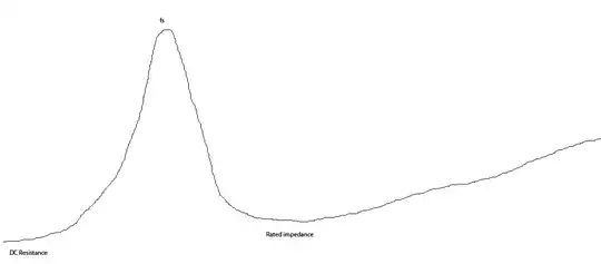

First of all, it's pretty rare for a speaker's impedance to be anywhere close to flat. The impedance curve normally looks vaguely like this:
The peak is fs, the speaker's free-air resonance. The rated impedance is the first minimum in the impedance curve above resonance. The DC resistance will usually be a little lower than that, but not typically a lot lower (e.g., might be around 6 ohms for a speaker rated at 8 ohms impedance). The DC resistance is also affected by other factors though--for example, a speaker intended to handle more power will typically have thicker-gauge wire in the voice coil which will reduce the DC resistance, but have almost no effect on impedance at higher frequencies.
When you mount that driver in a box, you typically add at least one (and often a couple) more, smaller peaks at lower frequencies that reflect the resonant frequency of the cabinet and any ports it may have.
