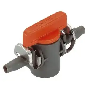

I once was looking for a similar thing and came up with following low cost (< 10 EUR) solution, that requires however some handicraft:
  • Plant watering valve (normally for manual operation; e.g. Gardena, see picture; < 4 EUR) operated by
  • a cheap servo (normally used for RC models; < 5 EUR)
Gardena valve

  • How much torque must the hobby servo produce, to be able to rotate the control knob? Would you recall what servo you used for this? +1 for unconventional and innovative solution, by the way. – Anindo Ghosh May 30 '13 at 17:00
