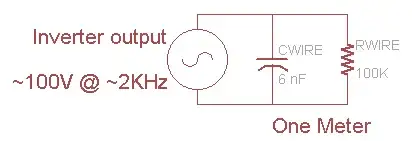

In terms of thinking of how EL wire 'acts' you should model it as a capacitor that increases with the length of the wire. It is not a perfect capacitor, there is also some leakage which we will model as a resistor.
alt text

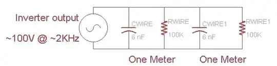

Adding another meter, we duplicate the RC model in parallel alt text Of course, we can simplify by calculating the new capacitance and reistance. Remember that capacitance increases in parallel and resistance decreases

The capacitance and resistance per meter depends on the 'thickness' of the EL wire, the brand and make, the voltage and frequency applied
