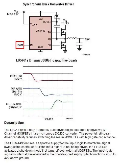

You could try using one of these: -
The trouble is with this type of driver for the FETs is that you cannot turn both FETs off; one or the other is always on. The saving grace of the 4449 is that when the PWM signal is inactive it will turn both FETs off.
