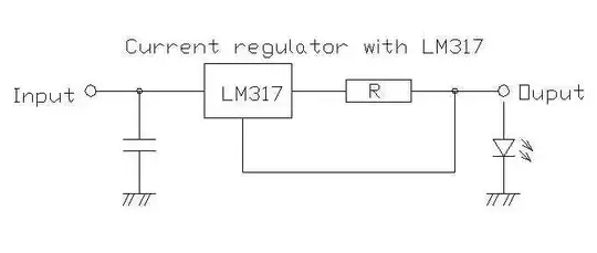

The easiest way of obtaining a constant illumination from an LED across a wide range of supply voltages, is to use a constant current driver circuit.
This can be made using, for example, an LM317 as a constant current source:
Alternatively, use a constant current 2-terminal device such as the SuperTex CL220 or CL2, simply wired in series with the LED. In other words, it is as simple as using a current limiting resistor with the LED, just with one of these parts instead of the resistor.

  • When using an LM317 in the above 'current regulator' configuration, would the IC get hot in the same sort of way they do when working as a voltage regulator (i.e., will I need a heatsink if input is 30V)? Also, thanks for the link to the Supertex CL2, I had not seen these -- in TO-92 package form this would be similar cost but smaller board space than a LM317 or 7805 solution which is great. –  Nov 06 '13 at 14:49
  • @j-roc The power dissipation by the LM317 would be the difference in voltage times the current (10 mA if you follow my suggestion above). That's 270 mW of heat if you assume a 3 Volt drop on the LED, up to 300 mW if you short out the LED leads. Not really a huge concern, I suspect. The SuperTex parts are small wonders - I've sampled a few of that family of parts, and have never stopped swearing by them ever since. – Anindo Ghosh Nov 06 '13 at 18:52
