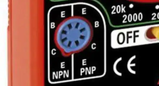

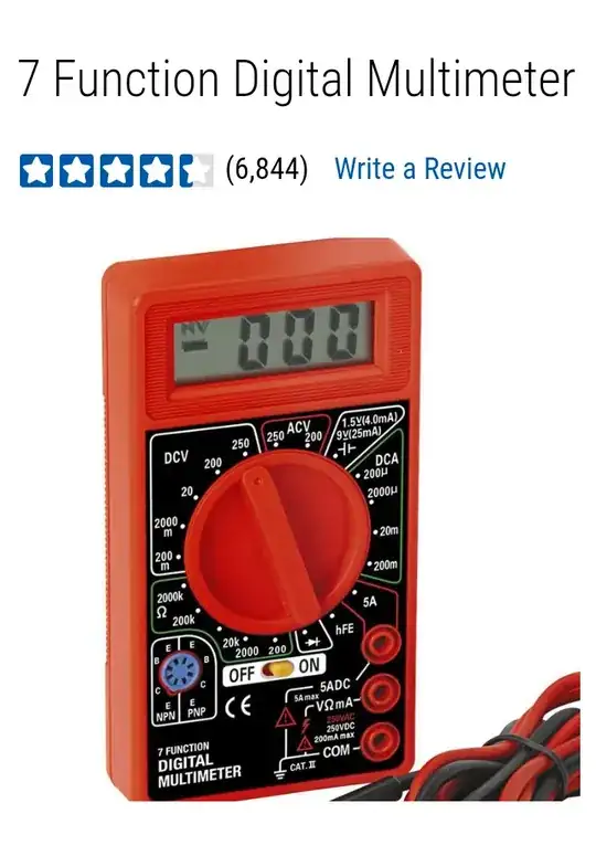

  • Harbor Freight multimeter. They actually work quite well. RS has some slip-over test lead IC-hooks that work with the bundled test leads, totally worth the extra cost. More expensive meters are better, but these are accurate enough (esp. for digital work: is it high? is it low? it's cheaper than a logic probe!) and small enough to go in a small tackle/toolbox, and if something goes wrong it's easy to replace. The transistor tester (shown below) enter image description here saved me when I picked up some 2N2222's at RS and discovered that the package had the pinout backwards. Seriously, even if you have a nicer meter, you will find uses for one of these.
