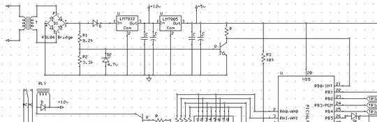

A while ago I created the exact same thing... a light dimmer using a triac with the timings calculated from the zero crossing signal send to the interrupt pin on a pic16f877a.
I took the zero crossing signal from the PSU that powers the circuit before it's smoothed and regulated. There are a few components to change the rectified humps of the AC into very short +5v pulses of around 200uS. Most of the time, the transistor (shown as Q in the diag) is conducting pulling the RB0/INT pin low, but when the AC dips below 4.7V briefly it stops conducting and the signal is pulled high by the resistor R.
Zero Crossing Schematic
The pulse is centred around the zero crossing, and it should be short enough to roughly detect the zero crossing moment. But you can fine tune this in software, by first detecting the rising edge of the pulse, then timing when the falling edge happens, then dividing this in half and adding this time period to the next rising edge... this will give you the exact zero crossing.

  • What are the specs for the transformer you're using here? What reasoning did you use to determine the values for R1 & R2, and for the capacitors? – Isaac Sutherland Jan 07 '11 at 04:18
  • Well I'm in the UK so my mains is 230v 50Hz, so my transformer would be different, I can't remember exactly but it would likely have been a 230v primary, 2 x 12v secondary 3VA transformer. The circuit will work just as well with your voltage / frequency though. – BG100 Jan 07 '11 at 04:22
  • The capacitors don't have any bearing on the zero crossing circuit as they are just for smoothing the supply. I think the resistor values were chosen by trial and error to get them right, the other important components are the Zener diode and transistor. If you put a scope on the output of the zero cross circuit, you'll get a very short quick 5v pulse at exactly the zero cross time. – BG100 Jan 07 '11 at 04:27
  • Also, I notice that your concerned about the safety of working with mains voltage, with this circuit as long as you have all the wires insulated properly up to the transformer before you plug it in and switch it on, then everything else is at a safe voltage... Apart from the triacs of course but they are out of the scope of this question. – BG100 Jan 07 '11 at 04:39
  • While this will work to some extent, there's much more that could be done. You'll find that there's a lot of noise around the zero cross point in some buildings so you could get multiple transitions. Filtering will help but then you have a delay problem, the edge you see with micro is delayed from the actual zero crossing. The transformer is also adding a delay, which will be load dependent (load on the secondary side). This is actually a very hard problem to solve, search for Lutron's patents on RTISS. – Martin Jan 07 '11 at 16:41
  • @Martin: I didn't have any such problems when I did this. The load on the transformer is very small and constant, and I ran it from a noisy diesel generator whos load was shared with motor inverters... it worked perfectly. – BG100 Jan 07 '11 at 17:15
  • Is there any particular reason your voltage regulators are in series? Is the 7805 more efficient when the input voltage is lower and more constant? – Isaac Sutherland Jan 07 '11 at 21:24
  • The reason was that I needed 12v to power a relay, and 5v for the PIC. Just part of the design of the circuit. If you don't need 12v then just omit the 7812 regulator. – BG100 Jan 07 '11 at 22:11
  • Why are the capacitors connected in parallel? I'm guessing it was some kind of protection for the electrolytic capacitors, but I can't find anything online that says a parallel ceramic capacitor is a good protective measure. – Isaac Sutherland Jan 08 '11 at 17:20
  • The small capacitors are to filter out noise from the microcontroller, I recently found out however that it's better to put them closer to the chip. The electrolytic caps are just to smooth the 5v. – BG100 Jan 08 '11 at 17:43
  • I'll just pretend there's a capacitor at the 7812's input :-) – stevenvh Jun 01 '12 at 13:54
  • The transistor will remain in conduction until the voltage is 2.45V not 4.7V. Either D2 or the transistor with its pull-up are superfluous. – stevenvh Jun 01 '12 at 14:22

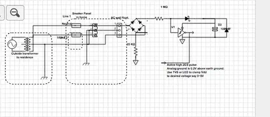

  • It is possible to make a ZCS in < 1mA.
  • You need to buffer with an external supply.
  • Leakage to ground is < 1µA
  • Safety Agencies require it to be < 500µA.
  • External wiring shows connect to Line and ground only...
  • Neutral is not required but may be used instead.
All passive parts must be rated for 1.5kV. Any small signal silicon bridge will do. Schottky diode powers the Schmitt inverter to provide noise free hysteresis. Input cap and ferrite bead to inverter input will assist with RF rejection.. 100pF without phase shift.
  • Use trailing edge of +ve ZCS pulse to activate a pulse to Triacs or latches as the pulse staarts before zero and finishes after zero V. Pulse width depends on resitor ratio and Zener voltage for chip or use 3V white or blue, LED 3mm or 5mm. It will not illuminate much , just a cheap zener.enter image description here
If target device is grounded to AC ground, you must use a simple signal pulse transformer or OptoIsolator with different bridge divider resistors and no inverter then.Bridge to opto darlington directly with ceramic input current limiting resistor.

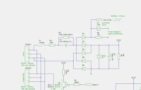

I needed a similar solution. I happened to also require 3.3V to power a microcontroller, through a non-isolated supply. In this case it provides a square wave at 50 or 60 Hz; a rising or falling edge signals a zero crossing point.
Danger of Death - Non-isolated power supply, trained people only.

  • I've opened a question to clarify what is meant by "trained" in this context: http://electronics.stackexchange.com/questions/8678/basic-training-for-working-with-120v-ac – Isaac Sutherland Jan 06 '11 at 23:20
  • Why did you use a non-isolated solution? – tyblu Jan 07 '11 at 07:39
  • @tyblu, Targetting a very low cost price range. In future I would probably use a non-isolated ViPER-12A or similar buck converter due to higher efficiency. – Thomas O Jan 07 '11 at 09:22
