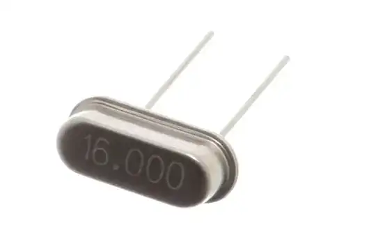

  1. What's the proper name for this: en.wikipedia.org/wiki/File:16MHZ_Crystal.jpg Crystal? Quartz crystal? Resonator? Quartz crystal resonator? Oscillator? Crystal Oscillator?
  2. This one have the same function as what I posted on #1 but less accuracy and stability?

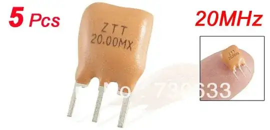

    i00.i.aliimg.com/photo/247949494/Ceramic_resonator.jpg Is it called Resonator? Ceramic resonator? Ceramic crystal? Oscillator?
  3. This is the same as #2 but have two ceramic capacitors built in? i01.i.aliimg.com/wsphoto/v0/1122545575/5-x-Radial-Lead-20-000-MHz-font-b-Ceramic-b-font-font-b-Resonator-b.jpg So what do you call it?

  1. Crystal, or quartz crystal. Crystal resonator is not at all incorrect but they have been called just crystals for over 50 years to no harm...
  2. Ceramic resonator; maybe just resonator, but certainly not crystal or oscillator.
  3. Basically yes. (The middle terminal will be ground). However there are also ceramic filters with this configuration, so be careful and double check the datasheet. (Especially if they are marked with common radio IF frequencies, 455 kHz or 10.7 MHz!)
