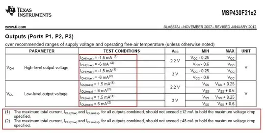

For the MSP430 series 2 page 21 of this document says: -
This tells me that if the combined output currents of several pins hits a certain limit then the output capabilities of any other pins (even those that may be lightly loaded) may be impaired by the same amount or possibly worse.
  • I did look at http://electronics.stackexchange.com/questions/50539/unused-mcu-pins-better-to-tie-to-gnd-or-use-software-to-prevent-floating and the others in that group of at least three duplicates. You make a very good point about overcurrenting the PSU pin - I think that's probably the biggest danger of connecting unused pins to GND/PSU. So.. the transistor on the GPIO pin probably just won't conduct nearly enough to damage itself (unless shorted to something way out of PSU range). – Dmitri Oct 23 '13 at 20:47
