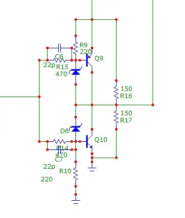

Hopefully, I will replace what I have now, which by the way works fine, but leaves a WHOLE lot of room for improvement... (image)
