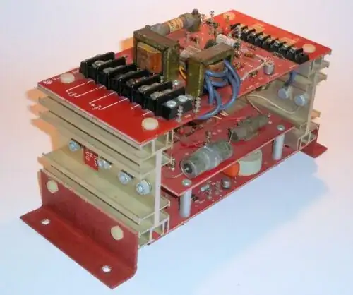

I know that this is an old question, but here is a picture of an actual product designed by my father 50 years ago. A Vectrol "Red-Pac" high-current AC phase control.
Thick FR4 is quite strong. Do not try this with a phenolic board! And this was a power board, so the traces are thick.
