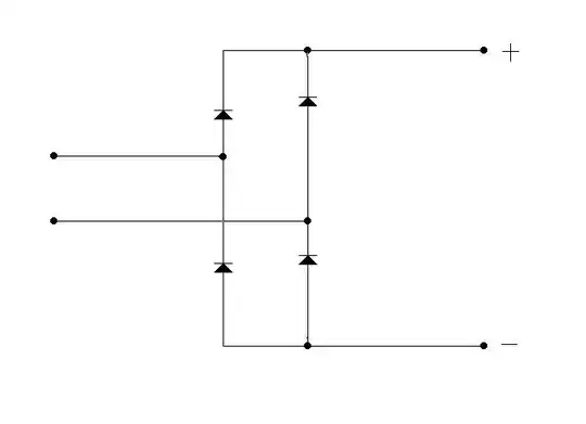

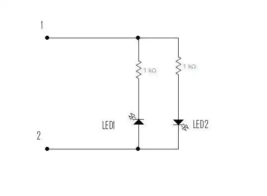

I give you a simple methode to determining polarity for your DC or ac power source not marked 1st circuit just 02 LED enter image description here
if the LED1 glow ==> 1 negative pole, 2 positive pole
if the LED2 glow ==> 2 negative pole, 1 positive pole
2nd circuit just by using a bridge rectifier enter image description here No matter what is the input (dc or ac power source) you got a positive voltage with marked polarity, just all
