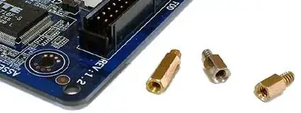

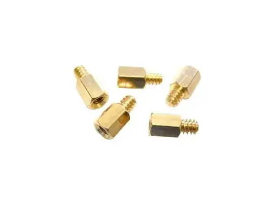

Not sure if your application is more sensitive than the computer motherboard, brass standoffs like these are commonly used in computer chassis. They connect motherboard ground to the chassis.
  • Available - These standoffs and screws are easy to get.
  • Reliable - I haven't seen one with corrosion yet in 20 years. (Reliable)
  • Monolithic - Less parts. As you don't want to provide special training to your assembly & manufacturing crew, this option has the least parts count and is straightforward.
According to wikipedia, certain brasses are used where there is a risk of corrosion from factors like chlorides, soft water, etc.

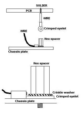

The pillars will provide an earth but this could be unreliable and using crinkle washers onto PCB copper is OK providing you don't fasten and unfasten a few times but whatever mechanical method you choose I don't think there is a substitute for a soldered wire from the PCB joining the chassis plate via a crimp type eyelet - you could even solder up the crimp if you felt belt and braces were in order. The inventory would be out of the mechanical guys hands because it is a part (albeit a small assembly) soldered to the PCB - that makes it a component in my book. Yes you still have to do a drawing so here's a start LOL: -
  • +1 I think this is probably what I am going to have to do (or at least have available as a backup solution). However I feel I have to give Chetan the check-mark because he answered the question I asked: What's the best material for the stand-off? – The Photon Oct 25 '13 at 18:37
  • @ThePhoton no probs chief – Andy aka Oct 25 '13 at 19:23
