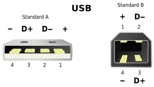

I have a USB keyboard. As I work many times in the darkness, I put some LEDs into the keyboard case. I connected two pairs of yellow standard LEDs serially to the USB power lines (Vcc and ground, pin 1 and 4).
Now when I plugin the keyboard the four yellow LEDs turn on for a second, begin to flicker and then turn off. The keyboard works, though.
Standard LEDs need about 20 mA, if driven at the correct voltage (2.5 V might be a bit to much, that means they possibly need more than 20 mA). So for two pairs of serially connected LEDs that would only be 40 mA (or maybe a bit more due to overvoltage — at least I am sure that they need more than 1,67 V, because if I connect three LEDs serially to the USB, they don’t light up).
Why does that happen? Does the keyboard possibly tell the computer that it doesn’t need so much current/voltage and then the computer cuts it down?

Sorry I am just an idiot. I wanted to measure the voltage on the keyboard. Then I noticed something: I have soldered the LED array to a very big pin, that I thought it would be the ground (from my experience the ground is mostly found on that big pins. But it was D+, a data wire. I have then resoldered this wire to the real, very small ground. Now it works. The LEDs stay lit.
