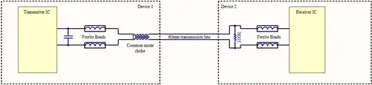

Here is what I believe is the schematic for the LVDS components:
LVDS EMI filtering
Clearly they have had to add all of these components in order to pass EMC testing. I'm quite surprised about the ferrite beads. I've often seen capacitors used in those locations to achieve AC coupling. I would never have thought of putting ferrites in there.
I am designing hardware which implements EtherCAT using the ET1200 ASIC. I would like to pass EMC too, and so I guess it would be wise of me to use the same components.
Questions: What likely values of capacitor and ferrite bead would I need to use? Are there any documents which discuss such EMI filtering techniques for LVDS?

  • @Andyaka - That's another TX circuit. This device has two bi-directional ports. From the left, you can see the RX circuit with its two ferrites, then a TX circuit with the choke, then another ferrite pair, then another TX circuit. – Rocketmagnet Oct 11 '13 at 19:57
  • is there a possibility that the dots on the CM choke are the other way round and that it is acting more likea balun. – Andy aka Oct 11 '13 at 20:06
In general the the ferrite beads and common mode filters are used to suppress conducted and radiated EMI. This suppression is usually needed to meet radiated EMI specifications.
The goal is to suppress harmonics while passing the fundamental frequency.
Murata has an application note that discusses this without getting into to much math.
see here -> http://www.murata.com/products/catalog/pdf/c35e.pdf

Since the 100MHz LVDS signal is quite weak, the impedance of ferrite bead should not higher than 100ohm, and the CM impedance may depend on the practical noise on CM signals. Do you find the solutions now?
