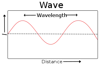

I think, in the below drawing, the green line is the wavelength. So, why measure it with a unit of distance?

The plot you provide gives the amplitude versus time so there is no length, other than "length" of time, i.e., period) to speak of. Without further context, what you have plotted there is a simple sinusoidal function of time, not a wave.

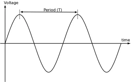

The parameter labeled on your figure as "wavelength" is actually called "period" and is measured in time units (of course).
Wavelength is the distance (in space units - mm, m, km, etc.) between two periods of some wave (mechanical, electromagnetic, etc.) in the space where this wave propagates.
Note that the wavelength depends on the speed of propagation of the wave in the specific medium. If the wave propagates slowly is some medium, the wavelength will be shorter (the wave will moves on shorter distance for the given period of time)

  • So does wavelength actually means "the 'straightened up' length from a crest/trough/zero crossing to the next one". Straightened up by the way means imagining the wave as a straight line. – Zaid Khan Oct 04 '13 at 11:51
    @KhanZaid No, not straighten up, as shown in the figure you posted. It's the product of velocity and period of the wave, the distance of the signal which it repeats. – Iancovici Oct 04 '13 at 12:04
    @KhanZaid No, if I understand you correctly. The term "wavelength" is related to some periodic signal, only if this signal is moving through some space, in a form of wave. Your graphic is about the value of the signal, measured in one single point in different moments of time. That is the difference. – johnfound Oct 04 '13 at 12:06
  • @KhanZaid It is the distance between the two points, not the distance along the curve (whose Y-axis may not be position anyway, it only is for transverse waves) - it's not clear which you mean by "straightened up". – Random832 Oct 04 '13 at 16:33
