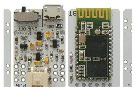

Example: In the following image of a PCB (pulled from Google images), there is a USB connector situated fairly close to the PCB antenna: enter image description here

    Your are looking at a module, probably designed by someone with a degree of RF knowledge, soldered to a carrier board, probably designed by a different person *without*. It's possible that the thickness of the board stack is sufficient to validate the design assumptions of the antenna, but it's also possible that this assembly is "wrong" but "workable enough" for the application need. It's not like high SWR at the power levels seen here is going to overheat the final amplifier - it will just make the radiation pattern other than desired, and possibly detune things enough to encourage spurs. – Chris Stratton Oct 02 '13 at 19:50

1) As much as possible. If possible, nothing should be to the side of the device for as many mm as possible
2) This depends on the antenna used and its radiation pattern (where the lobes are). You want to interfere as little as possible with these lobes
3) Any metal should be kept out. Copper traces could make things worse since it would cause noise and might fail FCC certification.
The reality in the answers is this. Give as much clearance as you can and most of all follow the manufacturer rules. If a certain product can only give 5mm of clearance, then it is what it is. It will affect the radiation pattern, but how much is difficult to tell unless complex simulations or an anaechoic chamber is used.
As a point of reference look at the small USB transceivers sold with Wireless Mice. The transceiver is inside the actual USB connector, with only the antenna sticking out. For marketing/design purposes, they kept it very short and they typically get away with it, although the range isn't the best. But, for their application where the mouse is only a few feet away it is good.
I've done a few products with very tight routing and antenna location. When things got very bad and the effects of the metal surrounding the antenna or routing cause packets to drop, the solution was to move the antenna. Basically use a U.FL connector or similar with a small 50 ohm cable (these are specially built) and place the antenna in another location, or have a custom antenna made that can give you the radiation pattern you desire.
So, in the end the design depends on many other factors. You don't always get the luxury of the perfect keepout area.
