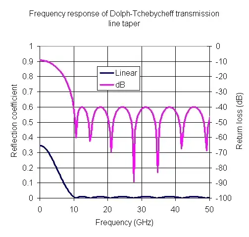

What you're asking about is called a transmission line taper.
In general, there's no analytical solution to describe the reflections. The link in Chris L's answer (if you follow through to Klopfenstein's paper) gives some examples of specific taper shapes where something close to an analytical answer has been found.
The basic way to study it is to imagine breaking up the continuous taper into several segments, each with a slightly different Z0 value. You calculate the reflections at each discontinuity and how they add up to give the overall reflection and transmission characteristics.
Then you split up the taper into finer and finer steps (with smaller and smaller discontinuities in Z0) until you have a good enough approximation to the continuous taper. You could try to calculate the results by hand but it's much easier to just get a computer program to do do it. Luckily, this kind of program is pretty easy to find --- it's called a finite element simulation program.

Please note, tapering is very effective and dramatically reduces the total magnitude of the reflection. As shown in scld's citation, the total magnitude of the reflection from a taper is much much less than the total magnitude of the reflection from an abrupt discontinuity.
In this example, the reflection coefficient can be easily designed to be <1% at the frequency of interest.
For a common-sense explanation, it is helpful to think of anti-reflective coatings that are used in optics. In optics, reflections are caused by an abrupt "impedance mismatch" between two materials with mismatched indexes of refraction. An anti-reflective coating significantly reduces the magnitude of the reflection, and the way it works is it consists of several layers of gradually increasing index of refraction, that together form a stair-step approximation of a continuous taper.
