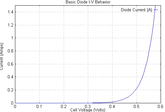

PN junctions are not resistors. Whereas the voltage across a resistor is proportional to the current through
\$v_R =R \cdot i_R \$
the current through a diode is approximately:
\$i_D = I_S(e^{\frac{qv_D}{kT}}-1) \$
In words, the diode current goes up exponentially with the diode voltage.
The derivation of the diode equation isn't trivial but it isn't mysterious either; it's based on well understood device physics.

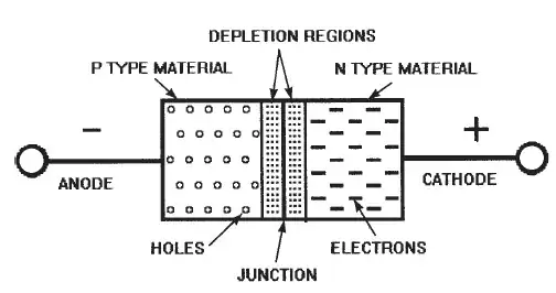

Diodes, on the other hand, are not "constant obstacles". There is a region inside diodes which is called a depletion region (or, sometimes, space-charge region) which is the most interesting part of a diode - it is this region which makes diodes (and transistors) so different from resistors. Depletion region (and effects associated with it) is very sensitive to the externally applied voltage.
  • For regular PN diodes, when the forward voltage across the diode increases, depletion region shrinks in size and allows for the current to flow "more easily" (when depletion region shrinks the voltage across it decreases). You can think of it as "doubling" the effect of the voltage: it causes more current to flow, and causes depletion region to shrink which allows for even more current to flow.
  • When reverse voltage is applied to the diode, depletion region expands. It is not causing the current to become smaller (at zero voltage there is no current through diode, but there is some current when the diode is reverse biased), but the expansion increases the voltage across the depletion region thus "neutralizing" the externally applied reverse bias, which prevents from current flow to ramp up.
The regular PN diode is based on the two points above: it allows for high currents to flow under relatively constant voltage while it is forward biased, and prevents reverse currents while it is reverse biased.
Zener (and Avalanche) diodes are similar to the regular PN diode, but they exploit the reverse-bias as the operating mode. As we said, the current through reverse biased PN diode is negligible because depletion region "neutralizes" the externally applied voltage. However, everything has its limits: when the reverse-bias of the diode crosses some threshold, the depletion region can undergo Breakdown (usually, it is non-destructive effect). When Breakdown occurs, it is like the depletion region is not there at all, and the current ramps instantly to very high values, while the voltage across the diode remains essentially as it was a moment before the breakdown.

A simplistic description of a diode. A Diode has two type of materials mated together to form a junction. A base material such silicon for an example, silicon is a non conductor. As you may know from physics Atoms have different levels of Electrons. Silicons Outer band has 4 Electrons (::|::) so it is a balanced Atom sharing Electrons with other Silicon Atoms. To make Silicon a conductor chemical element are combined either adding electrons or taking away electrons. What is important about this is that the silicon with only 3 electrons can take in electrons, while silicon with 5 electrons can only give up electrons. This how a semiconductor works the 2 element are mated together. ( .:<|>::. ) If current is applied in different directions. The outcome is as follows. The element with the 5 electrons can fill the holes ->|-> (.::<|>:.) of the element with 3 electrons (Their-forth Current flow). Reversing the current the element with 3 electrons (.::<|>:.) <-|<- has none to give up and the one with 5 can not take any (NO Current flow.) the 0.6 to 0.7 volts is formed at the junction of the 2 materials because their is a diffusion of holes and electrons trying to equalize charges at the junction, the area around the junction becomes charged positively toward the element with 5 electrons. This charge has to be exceeded before electrons can flow. 0.6 Volts

Diodes conduct current after a certain threshold energy (the bias voltage) is surpassed and orienting (rather minimizing) the depletion region in forward bias such that current can flow.
For zener diodes they are manufactured such that the reverse bias will also properly bias the depletion region for current flow. It's reverse biased because current is flowing in the opposite direction.
I would also like to point out that resistors don't always have the same resistance. Passive components (resistors, capacitors, inductors) have parasitic elements. This means at certain frequencies you'll see capacitive or inductive behavior of these components. You can tell this component by the phase change of a time varying signal compared to what you expect of an ideal component.
In summary to the main question: diodes are conducting current when the bias voltage minimizes the depletion region such that current can flow in the desired direction.
