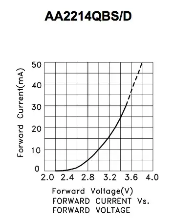

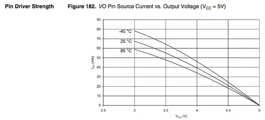

This is because of Voltage Droop. As you pull more current, the voltage on the ATMega's pin drops. Since LEDs have a correlation between voltage and current, this causes a sort of self-balancing act. (The First Picture is an LED v vs i graph, the second is the Pin driver v vs i graph from the ATMega328 datasheet)
The led and the pin driver eventually come to an equilibrium. As the source voltages drops, the led wants to pull less current. The problem is that this might be at a current that can damage the pin driver, AND damage the led. It might not be immediate, but it can drastically shorten the life of the Driver, and of the LED, and harm the accuracy of the driver as well.
Individual Arduino/ATMEGA Pins should only source 40mA, and that's with a 0.6V droop, The Port should only source 100mA, and the entire Microcontroller should only source up to 200mA. These are the limits of safe/recommended/tested use as stated by the manufacturer. Any more than that stresses the microcontroller, might be okay, might not, but it's a gamble.
There is NO current limitation in the pin driver. If you short a logic high pin to ground, you just drew a few Amps and killed the driver. If you want to pull 100mA from a 40mA recommended max pin, you can! It is up to you, the designer, to restrict current draw. The 40mA is a recommendation, like a speed limit. You can drive faster than the limit, you shouldn't for obvious reasons.
Leds can be driven above 20mA. That is the Typical rating for x amount of hours. You can give it more, it will be brighter, but will die sooner. ANd it's really because of heat concerns. The more current, the hotter the led junction gets, the more current it wants to let through and eventually it falls into thermal runaway.

  • i cannot understand from your explanation, why, when connected to a 'non-current-limited' source such as the digital IO pins, the LED failure behavior is different than connecting it to the power supply directly. – Andyz Smith Sep 29 '13 at 23:49
  • i guess really i'm confused why you assert that there is 'no current limitation in the pin driver', but make use of documenation labeled 'pin driver strength'. can you succinctly explain to one lowly as me, **what is pin driver strength?** – Andyz Smith Sep 29 '13 at 23:54
  • @AndyzSmith Essentially, it means that the Pin cannot drive its output to Voltage X at Current Y. As Current sourced Increases, Voltage Decreases. If you want to make sure an output pin is at least 4.7v, you need the current at least under 10mA. At 40mA, the voltage of the pin that should be logic high/vcc/5v is actually 4v. (Same applies to output low and sinking current. As current increases, the voltage rises from 0v to 0.5v or more) – Passerby Sep 30 '13 at 00:10
  • so, the current on the output pins IS limited. by the fact of this curve, will eventually cause any given load to stop pulling current as the voltage decreases to zero. These output pins are current limited in a way that the power supply pins are not. – Andyz Smith Sep 30 '13 at 00:18
  • @AndyzSmith No, these limit current the same way power supply pins limit current. Remember bulky linear wallwarts? A linear power supply listed as 12v 500mA, would at no/light load, have 18v, and at 1A would have 3v. Linear Regulators have Dropout Voltages that Increase as Current increases. A LM7805 will not produce its max current at a vin-vout of less than 2v. They all act like low value resistors. The output pins are **exactly like most linear power supplies**, except with poor voltage regulation and weak current source capacity. – Passerby Sep 30 '13 at 00:30
  • ok, i agree , the method is similar, do you agree that in this instance, the reason the LEDs don't burn out is because of different current limit curves between output pins and the 5v main line. – Andyz Smith Sep 30 '13 at 00:36
