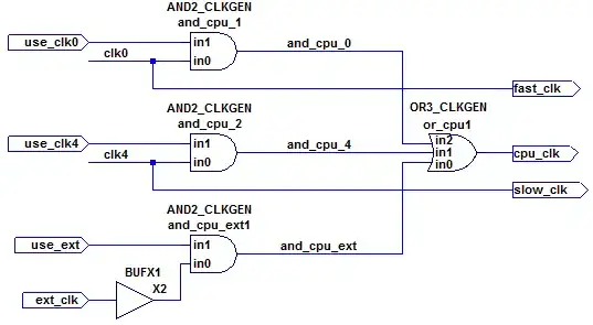

This is about the following clock multiplexer structure, which is part of the clkgen module which is again part of a larger design: Clock multiplexer schematic
While the ext_clk input is assumed to be generated externally to the design (entering through an input pin), the clk0 and clk4 signals are also generated and used by the clkgen module (see my related ripple clock question for details) and have associated clock constraints named baseclk and div4clk, respectively.
The question is how to specify the constraints such that the timing analyser
  1. Treats cpu_clk as a multiplexed clock which can be either one of the source clocks (fast_clk or slow_clk or ext_clk), taking the delays through the different AND and OR gates into account
  2. While at the same time not cutting the paths between the source clocks which are used elsewhere in the design.

...in the given structure, this is complicated by the fact that clk0 (via the fast_clk output) and clk4 (via slow_clk) are still used in the design, even if cpu_clk is configured to be ext_clk when only use_ext is asserted.

The use_clk0, use_clk4 and use_ext inputs are generated in such a way that only one of them is high at any given time. While this could be used to stop all clocks if all use_* inputs are low, the focus of this question is on the clock multiplexing property of this structure.
The X2 instance (a simple buffer) in the schematic is just a place-holder to highlight the issue of automatic place&route tools being usually free to place buffers anywhere (such as between the and_cpu_1/z and or_cpu1/in2 pins). Ideally, the timing constraints should be unaffected by that.

Define divide by 1 clocks on the and_* nets and declare them to be physically exclusive. Cadence RTL compiler handles the situation correctly by generating 3 timing paths for registers clocked by cpu_clk (one path each for one clock). Registers directly driven by clk0, clk4 and clk_ext have their own timing arcs.
create_generated_clock -source [get_ports clk0] \
-divide_by 1 -name and_clk0    [get_pins and_cpu_1/Y]
create_generated_clock -source [get_ports clk4] \
-divide_by 1 -name and_clk4    [get_pins and_cpu_2/Y]
create_generated_clock -source [get_ports clk_ext] \
-divide_by 1 -name and_clk_ext [get_pins and_cpu_ext1/Y]
set_clock_groups \
-physically_exclusive \
-group [get_clocks and_clk0] \
-group [get_clocks and_clk4] \
-group [get_clocks and_clk_ext]
Revanth Kamaraj
  • 430
  • Thanks for your suggestion. Unfortunately I currently can't verify this, but your concept looks quite promising to me. Could you check whether the paths between `cast_clk`, `cpu_clk` and `slow_clk` are still checked (i.e. not an exception due to the exclusive clock groups), while at the same time being constrained by their respective input clocks? Ultimately, I am looking for an authoritative answer to this question. – FriendFX Mar 22 '17 at 00:43
  • @FriendFX I've tested the code in RTL compiler and paths are inferred correctly. – Revanth Kamaraj Mar 23 '17 at 15:03
