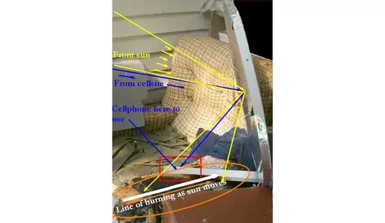

In my case we are served by a GSM system and in the past coverage around my home was poor as we are in a hill shadow relative to the local cell site and tend to get strong reflections on several paths, which leads to unstable areas of high and low signal across distances of feet and seconds. A phone may work almost perfectly one day and be almost unusable the next. This has now been fixed (extra cellsite presumably) but prior to that I used to make extended cellular free toll calls as part of my calling plan. I had line of site access to another cellsite but the range was excessive. SO I set up a UHF satellite dish (about 1 metre) pointed at the cellsite and with the phone simply placed on the LNA support arm with the LNA removed and the phone on 'loudspeaking. No electrical (wired) connection twixt phone and dish. Worked a charm. [Set up on my back porch next to an old armchair. Coffee, papers, cellphone, satellite dish - go.
Unrelated Bonus: Genuine story! For experimental purposes I silvered the dish with aluminised mylar film. It mad a proficient solar heater. My wife was concerned that the dish may set things on fire unattended. I pointed out the unlikely circumstances required to align sun, dish and a target as configured. One night I left the dish on a stool next to the armchair and next morning about 10am sun and dish angle and chair location conspired to set the chair alight!!!. It could have spread to the house :-(. But didn't., A lesson or few learned.
Don't try this at home if you want to still have one. Chair frame is solid pine - burning is more substantial than is obvious. ("Open image in new tab" gives much larger image on this and many other images.)

  • "with the phone simply placed on the LNA support arm with the LNA removed and the phone on 'loudspeaking" ... LOL and great solution. This reminds me of old episodes of "Green Acres" where they had to climb the phone pole to make a call as the phone company had run out of cable. – Tut Sep 25 '13 at 11:20
  • @Tut - See added photo :-) – Russell McMahon Sep 26 '13 at 12:03
  • Tis a "cool" set-up LOL – Andy aka Sep 26 '13 at 12:04
  • I guess the next step is a small hibachi on the chair arm. – Tut Sep 26 '13 at 12:39
  • @Tut (1) :-) (2) Solar heating was the main aim of the dish - I pressed it into cellphone service latterly. I used the aluminised Mylar to see what sort of energy a dish that size would provide with that reflective coating Ample, apparently :-). Final target is a 1.8m round satellite dish in 6 bolt together segments. Total area is 2.65 m^2 or 0.42 m^2/segment. Insolation at full sun is 1 kW/m^2 so 2650 Watt and 420W. If I can get about 50% of that actually available it's ~= 1300 W and 200W. I want to try water heating with a developing country water-sterilisation role in mind. – Russell McMahon Sep 28 '13 at 09:03
