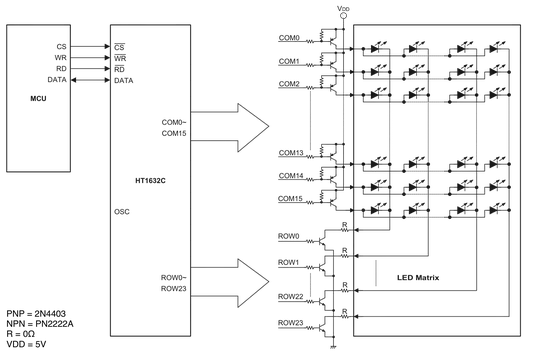

As my goal is to obtain the same brightness with my matrix than a continuous mode 5mm LED, I decided to try with more powerful LEDs and so I get SMD 5050 (PLCC6 3.1V 60mA) ones, using all of the three modules inside of them. I changed my shift registers for an HT1632C which is a dedicated component for LEDs matrix driving.
I followed instructions from HT1632C datasheet, especially the following diagram :
The results were more or less the same than the first ones (I succeeded in getting more brightness due to 5050 but not enough to reach continuous 5mm). So I decided to do several tests by connecting LEDs to 5V through resistors (to aim to get nominal current through them), and then without these resistors. I noticed a slight difference concerning the brightness but not so much.

Any LED multiplexing solution will inherently reduce intensity of the LEDs pretty much linearly by the factor of the multiplexing duty cycle. This change in intensity is not identical to the change in intensity observed when current through the LED is reduced by changing series resistance: The resistance value is not directly the determining factor, the resultant current through the LED is, and that does not enjoy a linear relationship to resistance.
The human eye's perception of intensity of light, LED or otherwise, is far from linear: Intensity variations at low LED intensity, or for that matter in low ambient light conditions, are much more sharply perceived, than a similar change in intensity at a brighter point in the intensity curve, or under brighter ambient light conditions. This explains why the change in resistors did not show a significant change in perceived intensity.
To answer the specific question about over-driving LEDs: Yes, that is a standard mechanism for countering loss of intensity in multiplexed displays. To counter a 8-way multiplexed LED display's intensity drop, i.e. 12.5% duty cycle per LED, hypothetically the LED should be driven at 8 times the constant current. However, that is rarely practical, so either compromises must be made, or risks of LED damage must be accepted.
How much a given LED can be safely overdriven by, is (a) possibly specified in the datasheet, but (b) more typically determined by the display designer through empirical testing, especially in hobby and low-cost applications, if the datasheet-specified overdrive current is not sufficient, and risk of LED failure is acceptable.

It seems impossible to get more luminosity with matrix multiplexing without largely excees the characteristics of LED. To obtain sufficient brightness, I plan to use shift registers with integrated LED driver such as TLC5940.
Each LED will be connected to an output of a register (cf. diagram). However, to drive 110 LEDs, it takes at least seven registers (in chain). I think this a "brute force" solution and I wonder if chaining many registers will not generate problems.
