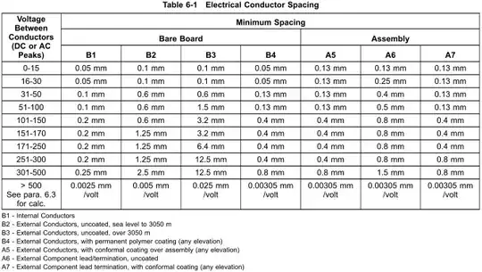

I would recommend the IPC: IPC2221A. They are conservative BUT most testhouses that then underwrite your design will only do so against the IPC. The IPC2221A become very annoying for uncoated terminals, especially at elevation. Personally I have been using the British Standards for uncoated clearance (for elevation & pollution) with an additional factor on top.
For voltages greater than 500V, the (per volt) table values must be added to the 500V values. For example, the electrical spacing for a Type B1 board with 600V is calculated as: 600V - 500V = 100V 0.25 mm + (100V x 0.0025 mm) = 0.50 mm clearance
