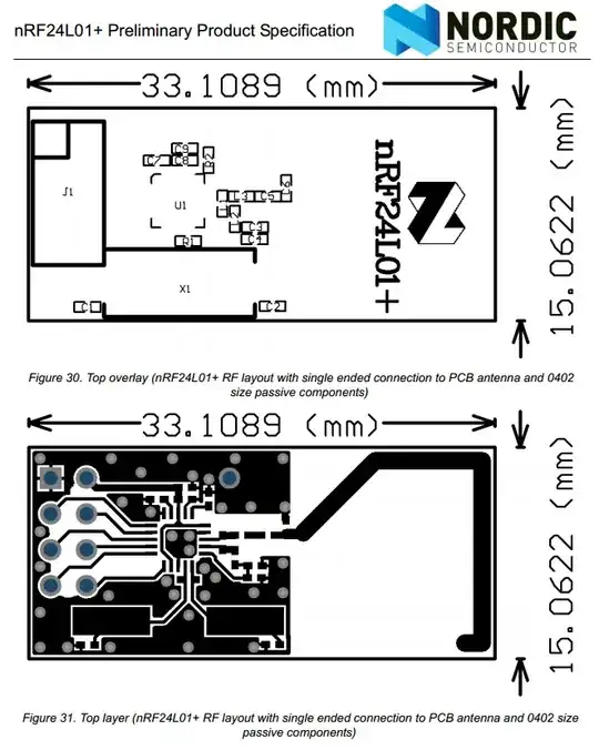

I am using http://arduino-info.wikispaces.com/Nrf24L01-2.4GHz-HowTo board for wirelss communication. I am curious as to which antenna is being used on the board. Could someone please point me to the correct BOM? Also who makes these boards? I know who makes the chip but I see these boards on ebay and several other places? So who is the original designer of this breakout board?

The data sheet for an IC is usually a good place to look for reference designs
The manufacturer's website is also a source for information about antenna design - Quarterwave printed monopole antenna for 2.4GHz
