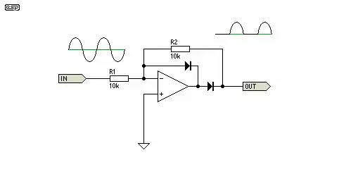

The low threshold voltage (essentially 0V!) can easily be reproduced with an active half wave rectifier as shown in the image below (found on Elliott Sound Products).
The operational amplifier is used to eliminate the (rightmost) diode's threshold voltage by inserting the diode within the feedback loop. The positive halve waves are amplified by -1 (\$A = -\frac{R2}{R1}\$), so essentially it is an inverting rectifier. With a sine wave you won't notice the difference as both half waves are symmetric.
The leftmost diode prevents the opamp from being driven in saturation (low rail) during the positive halve input wave. Subsequently the inverting input will act as virtual ground (V- = V+) which stabilizes the circuit.
This circuit only works reliably with a dual power supply as the opamp's output will be driven about 0.6V below ground.

  • Unsure if an active rectifier like this is low noise enough for your application, [some germanium diodes](http://pdf1.alldatasheet.com/datasheet-pdf/view/166124/ETC1/OA95/+0W5247VwSwJbREDz+/datasheet.pdf) I checked were marked 'very low noise'. – jippie Sep 17 '13 at 20:00
  • I like this, it accomplishes what I need it to. I'm assuming I can use 1N914 signal diodes for the two in the schematic? I'll give it a few days before accepting to see if there's anything else, but +1 for now. – Bryan Boettcher Sep 17 '13 at 20:41
    You are going to need a op-amp that is able to operate at the RF frequencies you're hoping to tune. – Connor Wolf Sep 18 '13 at 04:44
  • @ConnorWolf Oh I didn't think about the RF frequency ... good point. – jippie Sep 18 '13 at 05:26

You are talking Active circuits here .This means that power is available .The Opamp active rectifiers would need a good fast opamp .Jellybeans like LM324 are far too slow.If you apply some foward bias current on the diode you can overcome the foward drop issue .When this is done the common Si diode say 1N4148 will work as well as the rare say OA81 Ge diode .This prebiasing has been done on early solid state radios before I was born .If you do not prebias you get nonexistant weak signal performance and horrible distortion at medium signals .The old vacuum tube detector diodes were high impedence devices that did not need prebias. It can be said that the contact potential did the prebias. Sure I have lots of Ge devices but this is a non commercial site and I recommend you prebias your diode .If you get this detector right you can get very good sound quality .Operation is better at high impedence due to lower distortion and less tuned circuit loading .If you have some old small signal RF Ge transistors floating around they should make very good diodes.
