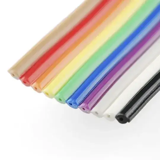

Is there any tool to strip ribbon cables (all wires at once)?
It's too time consuming and error prone to do it one by one.
ribbon cable
