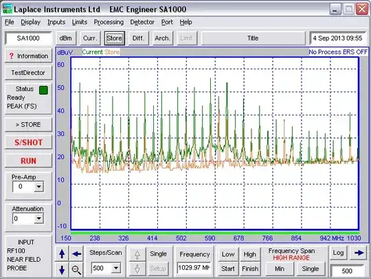

I recently did a proper EMC test on a PCB of mine. It failed the test, and seems to be radiating in the 300MHz - 1GHz region, with peaks every 50MHz, and little peaks on the 25MHz.
Radiated emissions
Looking at the near field, you can clearly see lots of 25MHz harmonics around: Near field 25MHz harmonics

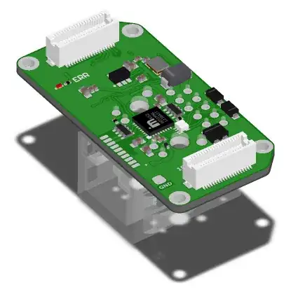

The Equipment Under Test consists of a pair of PCBs stacked together. The bottom one contains the 25MHz crystal and the chips that use it. The top one contains the power supply components.
PCB PCB
PCB Layers
Question for bonus points: How can it be that there are clearly lots of 25MHz harmonics around in the near field, but only 100MHz and 50MHz harmonics are detectable in the far field?

    I'll note that 1/10th wavelength is 640 MHz. You have a dominant peak @~ 600 MHz in the far field. I would be looking for fast edges with rise times on the order of ~ 1.5 ns. This will be your dominant emissive source. The 25 MHz side lobes are expected because the system has plenty of opportunities to mix in core frequency. For near field work, look to mix up E mode vs. H mode probes also. – placeholder Sep 10 '13 at 16:44
