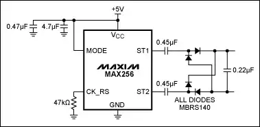

I know that an isolated supply can be built using two capacitors, but I'm not sure if that's exactly a dual, or if there's an equivalent to adjusting the ratio of turns:

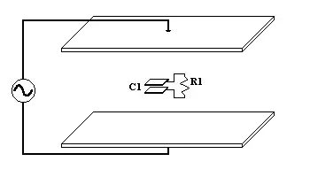

Or maybe something related to this?

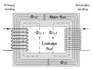

There is a dual to this. When you have devices sharing a common winding and magnetic flux(Magnetic "current") it makes a perfect dual for devices sharing a common electric conductor. Nice picture from wikipedia:
wikipedia image of flux in a transformer2
You can also take a look at "Magnetic Circuits". You can start learning some fun terms when you go into these concepts in detail, like "Magnetic Capacitance," it seems that my flux does have capacitance.
The way you can determine how much energy passes through a transformer can be broken down into a magnetic circuit that works just like an electric circuit with different units. Magnetic Circuits are an analog of Electric Circuits, which are much easier to work with for many many reasons.

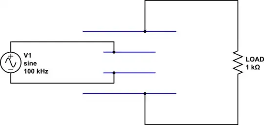

Okay, I've been chasing this down in my head for months now. I've built a couple prototypes, as an exercise in understanding the fields involved. I finally have an answer I can believe.
Say you have the original concept, a capacitor inside a capacitor. Compare that to this:

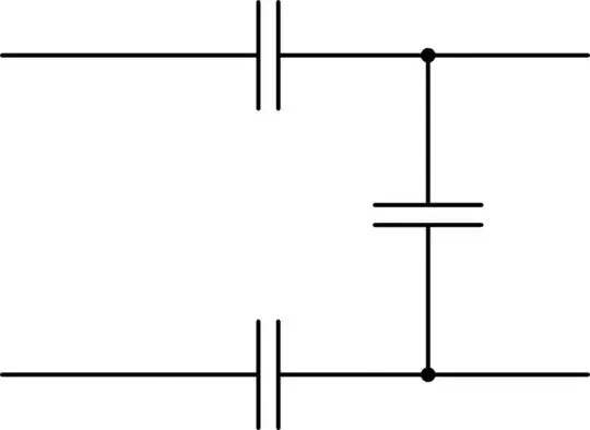

I would argue that this circuit is identical to our four-plate arrangement. Each of the inner plates of our four-plate stack is still a conductor with a great deal of surface area, and large capacitance to the plates on either side. We've drawn them as two separate plates with no impedance between them, but that electrically changes nothing. Now the circuit looks more familiar. It's really just three capacitors. And the one across the secondary really doesn't add anything, it just creates a voltage divider. You'll get that when you attach a load anyway.
This has some very similar properties to a transformer. DC can't pass from primary to secondary, but AC can. This makes the system galvanically isolated. However, this does not necessarily make it isolated for practical purposes! If you put AC between the primary and secondary of an ideal transformer, nothing happens. If you put AC between the primary and secondary of this circuit, you get lots of current flow. So this would fail an AC hi-pot test, and common-mode noise on one side would transfer happily to the other.
If those aren't problems for an application, there may be some advantages to this over a magnetic transformer. For one, you can transfer more power at higher frequencies, somewhat the inverse of a transformer. (Depending on the transformer, of course.) There are no obscurities of core materials and geometries to deal with. I suspect it's more efficient than a transformer, though I have no data to demonstrate that. Instead of eddy currents, hysteresis losses, and winding losses, all we have is the ESR loss in the capacitors, which I'd expect to be much lower. And it's DC-safe! If you put DC on a transformer, the core saturates and you probably break something. Put DC on this, and absolutely nothing happens.
Now, why can't we step up, if it's truly the dual of a transformer? Because electric fields and magnetic fields have some fundamental asymmetries. An electric field starts on a positive charge and ends on a negative charge. You can't expose a conductor to another conductor's electric field; the electric field of a capacitor definitionally involves two conductors, and if you try to introduce a third, it just moves some of the termination points. (Cartoon version, I am not a physicist.) But a magnetic field always ends where it begins, so a single conductor can have a magnetic field that the secondary can be exposed to with varying geometry.
In other words, it's because electric fields are unipolar, with each end on a separate particle. Magnetic fields are dipolar, starting and ending on opposite poles of the same magnet, forming loops. So amusingly, @JustJeff 's comment was inverted! We really need an electric dipole, not a magnetic monopole!

I don't know whether the three capacitor model above is indeed an analogue of the four plate concept. (Something that I have been puzzling over for the past 5 years or so without the opportunity do do any comprehensive experimental study.)
I would like to propose that the capacitive effect needs to surround the inner plates so as to ensure that the charge on the secondary (C1 in the original 4 plate diagram) is equal to the charge on the primary. This problem with the dual has been pointed out above with a mention of "multiply connected space" in reference to the magnetic coupling of the coils of the transformer. Here we need to have electrostatic coupling. (I'm throwing words around but I hope you get my meaning.)
When this is achieved (presuming the frequency of the supply is high to provide low reactances for the two capacitors) we could say that if Q = CV, and Q1 = Q2 then
C1V1 = C2V2 and you have something that is the dual of the Turns Ration for Transformers.
Inductive transformers, we know, are better at low frequency. The transformation - and transfer of energy through electrostatics - would be better at high frequency as the dual would imply.
As the transformation relies on the constant HF exchange of charge, you could call it a "Flux Capacitor" except that I think that name is taken! :)
My email address is jeffrey.stokes@tafensw.edu.au. I would invite any further discussion on this idea.
A late edit... If you want to step up the voltage, you just have to make the capacitance of the primary much higher than the secondary. Making the Primary the inner pair of plates would be the easiest way as the dielectric distance is naturally greater. If indeed C1V1 = C2V2 as my thought experiments have suggested to me then, in the primary, we would have a higher capacitance and lower voltage. In the Secondary we'd have lower capacitance and higher voltage.
I have devised an experiment using thin aluminium sheet, plastic film and nylon screws to hold together a practical 4 plate device. Electrical connection will be made at the edge of each plate. I'll be using a 100kHz supply and a 1 kOhm load. I will publish my results here and include images of the waves as well as RMS current in and out. I will them halve the frequency and check the "coupling". Further, I will decrease the capacitance for the outer pair by inserting extra layers of film and determine if that has the effect of increasing the output voltage as I predict it should.
    I've been thinking, for the past three minutes, about the three capacitor diagram above. It is definitely not equivalent. It is, in fact, simply three capacitors in series where the one in the middle drops part of the voltage. It is nothing more than a capacitive voltage divider; transforming, in a sense, and achieving isolation, which of course is a principal aim, but only dividing voltage; but never stepping voltage up!It comes down to what wbeaty said above. The dual, expressed as a practical device, needs to be based on equivalences between electromagnetics and electrostatics. – Jeff Stokes Jan 24 '15 at 04:36

It is worth noting in this context that the usual "capacitor" you put on a board has two poles, but there is nothing necessary about this arrangement. A loose conductor hangin out in space has a (small!) capacitance and is a capacitor.
