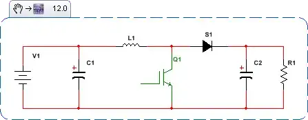

My example system for the purposes of this question: enter image description here
  • C1: 1000uF
  • C2: 500uF
  • L1: 500 uH
  • Switching frequency: 4 kHz
  • R1: Variable
  • Input voltage: 400 volts
  • Output voltage target: 500 volts
  • Output current limit: 20 amps
I'm trying to regulate the output voltage, without exceeding an output current limit. I have voltage and current sensing, which go through various amplification stages I'm not analyzing at this juncture, but which do include some filtering. This is followed by an RC lowpass filter of 100 ohms and 1000 pF directly at the A/D converter. The A/D samples at 12 kHz. This value goes through a single-pole IIR moving-average filter of the last 64 samples.

So I have a boost converter with two capacitors, a choke, a variable load (which could be a step function), feedback with single-pole RC filters, an A/D converter, single-pole IIR digital filters, and two PI loops feeding each other. How does one analyze such a thing from a control theory perspective (poles, zeroes, transfer functions, etc.), particularly to select my control loop parameters properly?

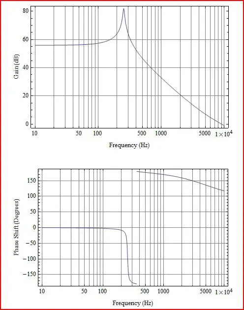

\$\frac{v_c}{d_{\text{ac}}}\$ = \$\frac{-V_{\text{co}} \text{DC}_o+V_{\text{co}}-L I_{\text{Lo}} s}{C L s^2+\text{DC}_o^2-2 \text{DC}_o+\frac{L s}{R}+1}\$
From this transfer function it is possible to see the location of the right half plane zero \$f_{\text{rhpz}}\$ and the complex pole pair location \$f_{\text{cp}}\$ .
\$f_ {\text {rhpz}}\$ = \$\frac{V_{\text{co}} \left(1-\text{DC}_o\right){}^2}{2 \pi L i_o}\$
\$f_{\text{cp}}\$ = \$\frac{1-\text{DC}_o}{2 \pi \sqrt{L C}}\$
For the circuit values of L1=500uH, C2=500uF, Vin=400V, Vo=500V, and R1=25 Ohms; \$f_ {\text {rhpz}}\$ is 5093 Hz and \$f_{\text{cp}}\$ is 255 Hz.
The gain and phase plots show the complex poles and the right half plane zero. Q of the poles is so high because ESR of L1 and C2 have not been included. To add extra model elements now would require going back and adding them into the starting differential equations.

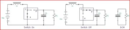

PWM Averaged Switch Model -- State averaging from the inside out
In the late 80's, Vorperian (a former student of Middlebrook) had a huge insight regarding state averaging. He realized that what really changes over a cycle is the switch condition. It turns out that modeling converter dynamics is much more flexible and simple when averaging the switch than when averaging circuit states.
Following Vorperian 2, we work up an averaged PWM switch model for the CCM boost. Starting from the point of view of a canonical switch pair (active and passive switch together) with input-output nodes for active switch (a), passive switch (p), and the common of the two (c). If you refer back to the figure of the 3 states of the boost regulator in the state space model, you will see a box is drawn around the switches that show that connection of the PWM average model.
You will want equations that relate the input and output voltages \$V_{\text{ap}}\$ and \$V_{\text{cp}}\$, and input and output currents \$i_a\$ and \$i_c\$ in an average sort of way. By inspection, and knowledge of what these simple voltages and currents look like, get:
\$V_{\text{ap}}\$ = \$\frac{V_{\text{cp}}}{\text{DC}}\$
and
\$i_a\$ = DC \$i_c\$
Then add the perturbation
\$\text{DC}\rightarrow \text{DC}_o + d_{\text{ac}}\$
\$i_a\rightarrow I_a + i_a\$
\$i_c\rightarrow I_c + i_c\$
\$V_{\text{ap}}\rightarrow V_{\text{ap}} + v_{\text{ap}}\$
\$V_{\text{cp}}\rightarrow V_{\text{cp}} + v_{\text{cp}}\$
so,
\$v_{\text{ap}}\$ = \$\frac{v_{\text{cp}}}{\text{DC}_o}\$ - \$\frac{d_{\text{ac}} V_{\text{ap}}}{\text{DC}_o}\$
and,
\$ i_a\$ = \$i_c \text{DC}_o + i_c d_{\text{ac}}\$
These equations can be rolled into an equivalent circuit suitable for use with SPICE. The terms with the steady state DC combined with small signal ac voltages or currents are functionally equivalent to an ideal transformer. The other terms can be modeled as scaled dependent sources. Here is an AC model of the boost regulator with an averaged PWM switch:

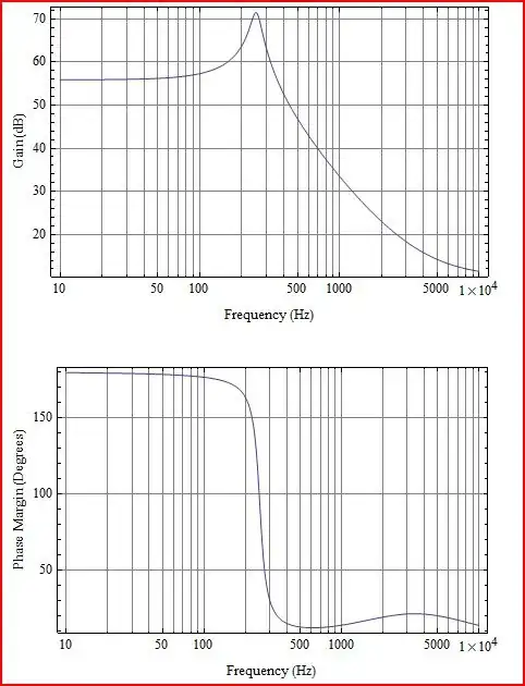

The Bode plots from the PWM switch model look very similar to the state space model, but not quite the same. The difference is due to addition of ESR for L1 (0.01Ohms) and C2 (0.13Ohms). That means loss of about 10W in L1 and output ripple of about 5Vpp. So, the Q of the complex pole pair is lower, and the rhpz is hard to see since it's phase response is covered by the ESR zero of C2.
