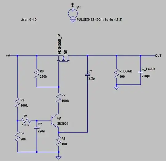

An NTC should work fine, as any transients will be supplied from the capacitors at a later time.
However, here is a pretty simple soft start circuit with a small difference from those seen commonly with an RC circuit on the MOSFET gate - I added some negative feedback to the emitter of the NPN to control the rise time more predictably.
Disclaimer - I have not tested this circuit, only quickly thrown together in SPICE, hopefully I haven't missed anything stupid though. Obviously you can alter values to suit your purposes.
EDIT - the MOSFET part number is not a recommendation (thanks Zebonaut) rather just a random SPICE part. Make sure to choose a suitable part for the circuit requirements. The NPN can be any general purpose part (like the 2N3904)

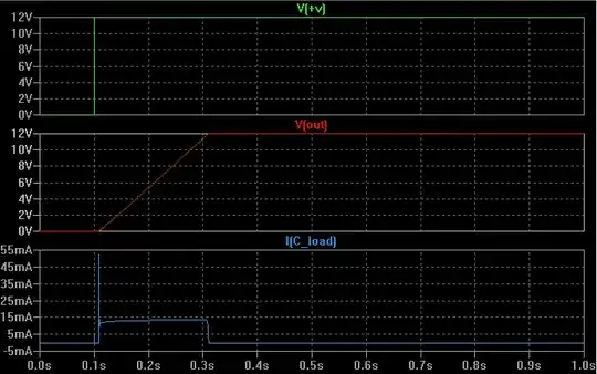

Simulation:

    This MOSFET circuit is nice and elegant. However, be sure to check the MOSFETs Safe Operating Area (In this case: https://www.fairchildsemi.com/ds/FD/FDS4559.pdf, page 9). With a current of approx. 15 mA (like here), all is fine, but more than 100 mA at 12 V is already too much. Quite unexpected for a device rated at 3.5 A! This is a little known but very common gotcha, especially for modern MOSFETs designed for switching applications when used in hot-swap (linear mode) circuits like here. See also: http://electronics.stackexchange.com/a/36625/930 – zebonaut Aug 28 '13 at 08:14

  • @zebonaut - good point, I actually just picked a FET at random from the list in LTSpice, so the part number was not meant to be a recommendation at all (I often forget to mention this) You are quite right about the SOA graph, very useful for getting a good idea about the part (as you say, many MOSFETs are designed with switching in mind, and some don't even have a DC rating on the SOA graph) – Oli Glaser Aug 28 '13 at 09:11

  • Could you please elaborate the exact function of the feedback capacitor C1? It seems to be pretty essential. I have a pretty large capacitive load of about 10000uF on a 9V 330mA AC/DC switching supply and thus would like to limit the current to around 300mA. However, I am unsure in what relation I have to dimension C1 and C2. – Rev Mar 16 '15 at 12:51
  • @zebonaut: Looking at the data sheet, I can't find a reason why 100mA@12V should be too much. I don't have much experience using MOSFETs. Could you please point me to the relevant information in the data sheet? – Rev Apr 09 '15 at 10:05
  • @Rev1.0 did you manage to find the answer to your last comment ? I have the same question. – efox29 Jun 18 '15 at 05:39
  • @Rev1.0 I see figure 19, that at DC, it's about 100mA, but that 12V would only last when the mosfet is swithing to charge ouput cap and as the cap charges, the Vds would decrease. – efox29 Jun 18 '15 at 05:43
  • @efox29: Yes, the SOA graph is the right place to look. To be exact, you would have to plot `Id` and `Uds` while the MOSFET goes through the linear region (switching/limiting current) and verify that it never leaves the SOA during any `Id(t)` / `Uds(t)` combination. Since that is not very practical you could just try assume the worst case condition. With V1=12V, Uds would be 12V at max. and that would allow about Id up to 100mA continuosly/DC. Also see my [follow up question](http://electronics.stackexchange.com/q/163939/16051). – Rev Jun 18 '15 at 06:45
