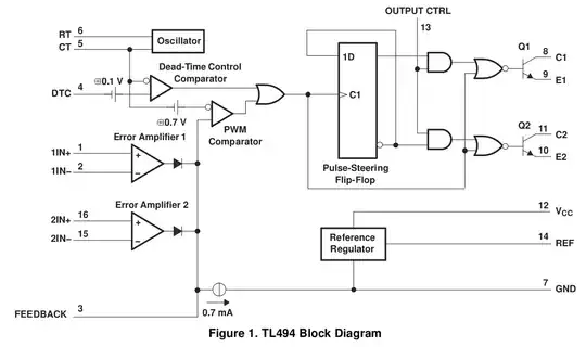

The TL494 is usually used in power supplies as the control mechanism for a buck or boost switcher, but can easily be used for PWM control of a LED as well since each of its output transistors can sink 200mA.
Take a look at TI application report SLVA001E, "Designing Switching Voltage Regulators With the TL494 (Rev. E)", to see how to put it into single-ended mode and to use the DTC to control the PWM output; a RC circuit on the DTC pin should be sufficient to gradually reduce the duty cycle upon device removal.
TL494 Block Diagram
EDIT:
Here is an unoptimized circuit that can be used. Note that the fixture will need its own power supply for it to work.
S1 can be either a lever microswitch or some sort of pair of contacts bridged with conductive material. When S1 is closed, DTC is held to 0V allowing maximum PWM duty cycle and therefore LED brightness. When S1 is disengaged, C1 slowly charges up through the R1/R2 voltage divider, slowly increasing the DTC voltage and thereby reducing the PWM duty cycle down to 5%.

  • OK, so the chip actually provides modulated power, which I read earlier is the "proper" way to dim LEDs. Definitely something I'll look into for my more refined models. Building the circuit is a bit complex for me right now, but I learn quick :) – Thomas Aug 26 '13 at 05:24
  • The chip uses PWM to turn the transistors on and off; the power is applied externally through the LEDs + transistors. – Ignacio Vazquez-Abrams Aug 26 '13 at 05:25
  • Wow, way above and beyond the call of duty, posting the block diagram. I'm thinking of using this chip with user27984's current buffer circuit. Most of the distributors on TI's site require minimum orders in the thousands. Is this chip common in anything, say computer power supplies, that I could rip apart? I work in IT, so dud power supplies are plentiful. – Thomas Aug 26 '13 at 06:10
    Don't order directly from TI. Distributors such as Digikey or Mouser will let you purchase singles. – Ignacio Vazquez-Abrams Aug 26 '13 at 06:28
  • @Thomas You can buy [3 pieces of TL494](http://www.ebay.com/itm/3-x-TL494CN-TL494-PWM-Power-Supply-Controllers-IC-/260816286409?pt=LH_DefaultDomain_0&hash=item3cb9dcb2c9) for under $2 including free international shipping, on eBay. – Anindo Ghosh Aug 26 '13 at 07:29

  • It can be pared down to a sawtooth generator and a comparator though, if needed. – Ignacio Vazquez-Abrams Aug 26 '13 at 08:29

  • S1 creates a short circuit across C1, draining it almost instantly. If you want to slow this down then you'll need to put a resistor in series with... I'm not quite sure yet... – Ignacio Vazquez-Abrams Aug 26 '13 at 17:42
