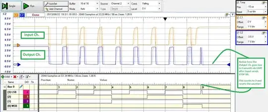

I have an oscilloscope measuring the N64 signal into the FPGA, and the other channel connects to the output of the FPGA. I also have digital pins recording the counter value.
Essentially, the N64 sends 9 data bits, including a STOP bit. The counter counts the data bits received and when I reach 9 bits, the FPGA starts transmitting via UART.
Here's correct behavior: enter image description here
The FPGA is the blue waveform and the orange waveform is the input of the N64. For the duration of receiving, my FPGA "echos" the signal of the input for debugging purposes. After the FPGA counts to 9, it begins transmitting the data through UART. Notice that the digital pins count to 9 and the FPGA output goes LOW immediately after the N64 is finished.
Here's an example of a failure:
Notice that the counter skips bits 2 and 7! The FPGA reaches the end, waiting for the next start bit from the N64 but nothing. So the FPGA times out and recovers.

  • @trav1s The "jump back" for the states occurs everytime I see the issue. I posted a screenshot in my answer so you know I'm not crazy! Thanks for the help so far. – Nick Williams Aug 23 '13 at 02:29
