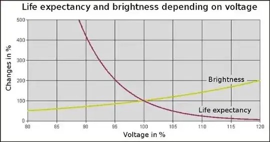

  1. Evaporation of the filament. The more voltage you put across the bulb, the more current will flow through the filament. The more current that flows through, the more heat and brightness in the bulb, causing the filament to evaporate faster and fail. (see chart)

The above image (source) was in reference to halogen lamps, but the failure/brightness curves should be the about same shape as for filament bulbs in general.
Burning out the bulb
Overvolting the bulb seems like the most straightforward way to cause controlled yet random failures. By this method you can control the lifespan of the bulb from months to seconds, depending on the voltage you set. The further above the bulb's specified voltage rating, the quicker it will fail. With a variable trasformer, you can easily dial in the voltage and approximate lifespan of your bulbs. (image source)
