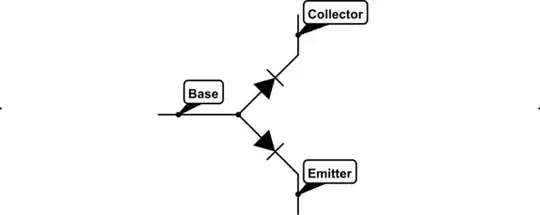

Equivalent circuit
To test a BJT it is essential to understand what the equivalent ciruit looks like. Here is the equivalent for an NPN:
Method
A total of 3 × 2 = 6 simple tests suffices:
  1. Base - Emitter diode. To test the diode, check with your multimeter (preferably in diode range, otherwise ohms) if the diode's measures is around 600mV in one direction and HIGH (O.L.) in the other direction. (a) Put one probe on base, the other probe on emitter, (b) then reverse. A short or an open indicates a defective transistor.
  2. Base - Collector diode. Same procedure as with BE-diode, but with different pin.
  3. Collector - Emitter not shorted. From the equivalent circuit it can easily be seen that it is impossible for current to flow between collector and emitter. With the diode tester check (a) if the two pins measure HIGH (O.L.) in (b) both directions. A short or lowish value indicates a defective transistor.
Do you have to desolder the transistor to measure it correctly? To be absolutely sure: Yes, but it doesn't hurt to check it in circuit. If you measure a short, take out. If it measures OK in circuit, you have a fair (though not 100%) chance that the transistor is OK.
