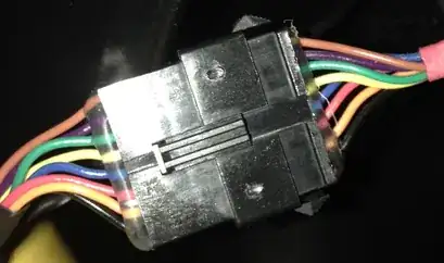

Let me first describe the setup. The treadmill has two major parts -- the dashboard, and the mechanical part with the running surface. They are joined together via 8-pin connector shown here:
Link to the image of my treadmill's 8-pin connector

    Are there any brains on the other side of the connector? Can you draw out a schematic of both sides? – Ignacio Vazquez-Abrams Aug 19 '13 at 08:25
    Or even post good-quality pictures of the electronics at each end of the cables. – Connor Wolf Aug 19 '13 at 08:31
