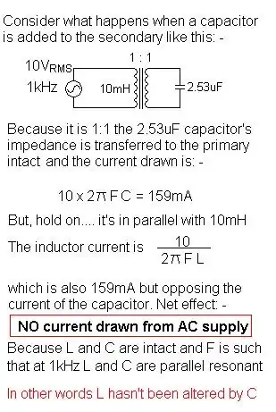

EDIT I'm adding a picture below showing a 1:1 transformer with windings that are 10mH each. On the secondary there is a 2.53uF capacitor and the primary is excited with \$10V_{RMS}\$ at 1kHz: -
Conclusion, adding a load of any description does not affect the primary magnetizing inductance of a transformer. If you put an inductor on the secondary you might think the primary inductance has reduced but in fact the added secondary inductor becomes in parallel with the never-changing primary magnetizing inductance.

    @dude. I hear what you say but the primary magnetizing inductance doesn't change - the load you put on the secondary takes current and this current (via the turns ratio modifier) is taken from the input wires to the transformer primary - in effect you are putting a load in parallel with the primary coil. If you had a loudspeaker and cemented the cone, you would expect to see much more current drawn when you power it with a sinewave - does the inductance change? If you stall a motor, it takes more current because the "load" is transferred, via magnetic coupling to the power source. – Andy aka Aug 22 '13 at 17:18
    @dude - I've added a drawing that might help you understand – Andy aka Aug 22 '13 at 19:33
