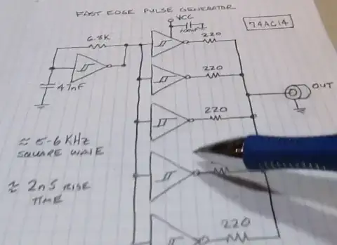

In W2AEW's videos, he builds a simple fast edge pulse generator using a 74AC14 hex Schmitt trigger (inverting) and demonstrates how to use it for capacitance and inductance measurements as well as a time-domain reflectometer.
W2AEW's Schematic

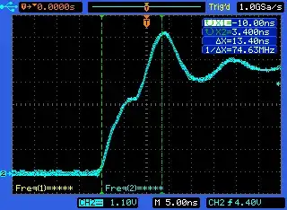

Per Oli Glaser's answer, the reason for the delay is that the probes were set to 1x rather than 10x, and limiting bandwidth, possibly as low as 10MHz. By setting the probes to 10x, the waveform immediately starts to resemble what it should (~13ns). The extra delay and capacitance is probably because I am using a breadboard and some unshielded jumpers to connect to the oscilloscope probes.
Here's the resulting improved display:
FEP at 5ns/div and probes 10x

  • 0.047μF is 47nF ... the schematic shows 4.7nF. That could account for the unexpected frequency you are seeing. – aja Aug 17 '13 at 23:41

  • @aja I will double-check the video, I thought it was 47nF. – JYelton Aug 18 '13 at 00:39
